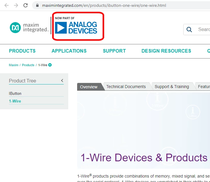

    @Community member​ "If it's still produced, it's now an Analog Devices product"
    They're still using the "Maxim" brand & website - for now:
    Who knows how long that'll last ...
