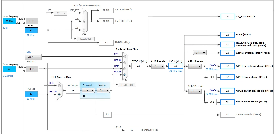

Thank you very much for your help, actually I am using cube MX to configure the I2S interface and I am using STM32L152RE-NUCLEO board, it seems in the clk config section, there's no specifed i2S clk config module ( see the screeshot in attatchment), so in this case how can I configure the i2s clock? Can I consider APB1_Prepherial_CLK as the I2S clk since I2S use PB1x pins?
I tried to measure the PDM sampling rate by measuring elapsed time in keil in this case, I don't know if it's fesiable?
Thank you very much

Regarding the question about I2S clock, It's true that STM32L1 has not a dedicated audio PLL:
I2S peripheral receive the clock from AHB clock. The clock tree shown in the image is a good choice for this use case.
The clock is then generated by I2S and it depends on the I2S peripheral configuration: in general, to target 1 channel recording with a PDM sampling frequency equal to PDM_CLK (for example 1.28 MHz), a good choice for the I2S parameters is:
hAudioInI2s.Instance = SPI2
hAudioInI2s.Init.DataFormat = I2S_DATAFORMAT_16B;
hAudioInI2s.Init.AudioFreq = (PDM_CLK / 32);
hAudioInI2s.Init.CPOL = I2S_CPOL_HIGH;
hAudioInI2s.Init.MCLKOutput = I2S_MCLKOUTPUT_DISABLE;
hAudioInI2s.Init.Mode = I2S_MODE_MASTER_RX;
hAudioInI2s.Init.Standard = I2S_STANDARD_MSB;
