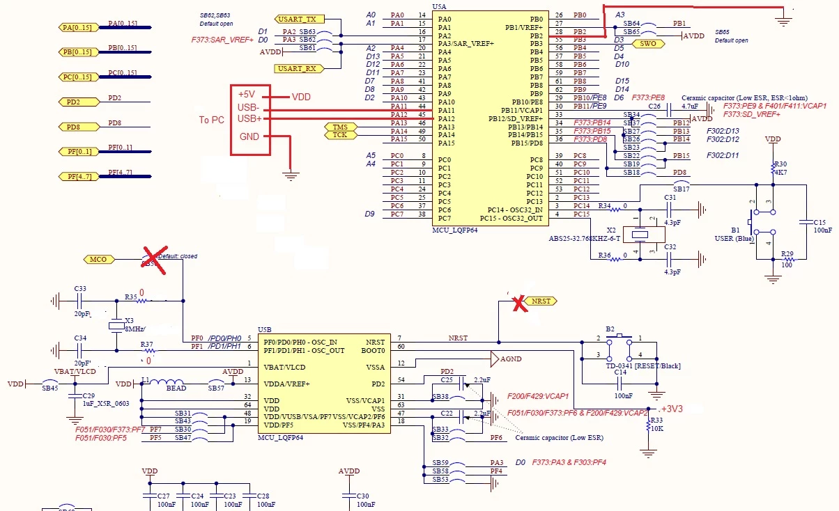

I am doing a firmware upgrade to a STM32F411RE using DfuSe application tool. But after I click ' Leave DFU mode', the MCU re-enters into the bootloader mode. I do not see this problem when I perform the same firmware upgrade on a STM32F401RE chip. Anyone can advise?  Thanks.

Posted on April 27, 2017 at 15:27
What is the state of the BOOT0 pin?
Is there a watchdog running?

Posted on April 28, 2017 at 09:32
Hi Clive,
I have connected BOOT0 pin to 3.3V. Watchdog is not active.
In fact, I have reworked a Nucleo board and saw the same behaviour. It re-enters into the bootloader mode after I leave the DFU mode. Attached is the schematic of the Nucleo board that I reworked.
