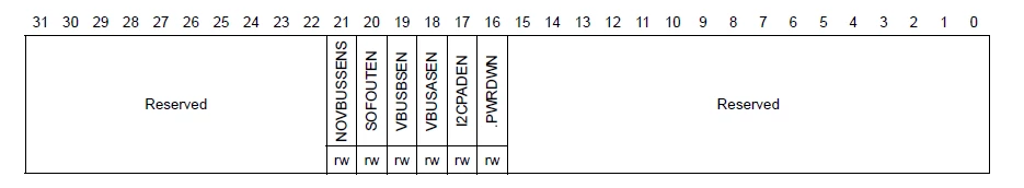

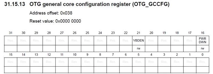

You didn't answer about a problem in the datasheet itself (not related to the library) :
3. In the Reference Manual, page 1100, it talks about the SOFOUTEN bit of OTG_GCCFG register, bit this bit is not defined regarding page 1140
What I need to do is to disable VBUS sensing because my PA9 pin is used for another purpose (USART).
But now that I know the library is incorrect, I'm still not sure if the datasheet is correct or not.
Based on what is written in the datasheet, I couldn't manage to disable VBUS sensing.
I'll have a look at STM32F4Cube to see how they do to disable VBUS, supposing this part is working.
Vincent.

The related reference manual will be updated. The SOFOUTEN bit shouldn't have been mentioned.
The GCCFG register definition is correct.
Please, refer to the USB example found under the cube package. It's already tested using the STM32F446 device.
Khouloud.
waclawek.jan
June 1, 2017
Posted on June 01, 2017 at 16:58
Khouloud,
I am now completely confused.
Does that mean that SOF is not available on PA8 for OTG_FS and PA4 on OTG_HS?
And that they both are not available as optional input to TIM2_ITR1 ?
Or does this mean that SOF is available out from OTG_FS/OTG_HS at all times, regardless of how OTG_GCCFG bit 20 is set; and it is gated only at the GPIO/TIM2 level?
Is this a 'F446-specific change, as compared to other 'F4 and 'L4 and 'F2 and 'F7?
Thanks,
Jan
Khouloud GARSI
Technical Moderator
June 8, 2017
Posted on June 08, 2017 at 15:02
Hi
Waclawek.Jan
->The OTG_FS_SOF and OTG_HS_SOF are available as alternate functions respectively on PA8 and PA4 pins.
-> Correct.
->The modification is for devices where GCCFG configuration register is different from:
The register is defined differently, so a new configuration should be applied.
Khouloud.
