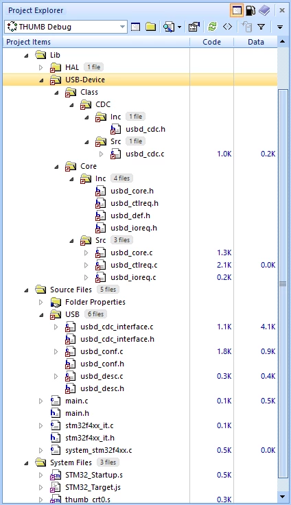

Hello to everybody,
using the USB-Device example for the STM324xG_EVAL (CDC-Standalone) I tried to get USB up and running on the STM32F4-Discovery-Board. The example is taken from the latest version of the STM32Cube firmware package.
My problem is, that I had no success getting USB to work correctly. All I get is a error message (Windows) saying ''Enumeration of device failed''.
Up to now, I already verified the system clock to be correct by toggling a GPIO pin in the SysTick ISR. The pin state toggles every 1 ms, which matches the required SysTick interval.
Also, I checked the preprocessor definitions, currently the following are defined:
  • STM32F407xx
  • USE_HAL_DRIVER
  • USE_USB_FS
  • HSE_VALUE=8000000
  • HSI_VALUE=16000000
  • HSE_STARTUP_TIMEOUT=5000
I have attached my main.c and main.h file, and also a screenshot of the CrossStudio project explorer.
My goal is to have a communication channel for �C <-> PC and vice versa - is the CDC-VCP example a good starting point?
What could be the cause of my problem? I already investigated this for many hours, but without any success.
If you need more information, please don't hesitate to ask.
Thanks in advance!
Alexander W.
#usb #stm32 #stm32f4 #discovery
