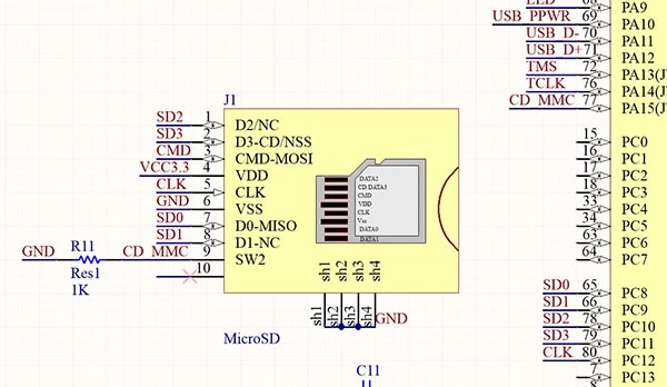

I am Using STM32F207VC And Micro SD Card With SDIO Interface And Fatfs Library
When I Debug And Trace Code, SDIO Routine Response This Error:
/*!< Card is not V2.0 complient or card does not support the set voltage range */
What Is Mean?
What Do I Do For debug This Error?
#fatfs #sdio #sdio #stm32f207 #dma-config-for-sdio

Describe the specific card (make, model, capacity, etc) you are having problems with. Are other cards working? Is the interface wired correctly? What board is this?
Make sure the SDSTATUS_Tab has 64 elements.
The error seems to suggest the card is non-responsive
Test the code/card on known working hardware.

hi clive And Tanks For Response
I Read A
Article
?About SDIO Interface
http://blog.frankvh.com/2011/09/04/stm32f2xx-sdio-sd-card-interface/
That Write About Hardware That must Use A Buffer For SDIO Voltage
My Board Dont Have Any Buffer And Connect MicroSD Driectly To STM32F207VC
Is There Any Issuse For This Problem?

I have my card detect with a pull-up, the socket grounds the pin.
You'd need to make sure you use external pull-ups on the data, and command pins, or configure them with pull-ups. This configuration works for an assortment of F2 and F4 boards.

The SDIO requires the PLL to be clocking to function. A board running at 2.7 - 3.3V shouldn't require any voltage adjustment. I'll assume no cards are working..
