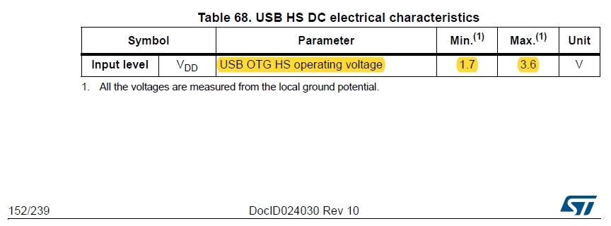

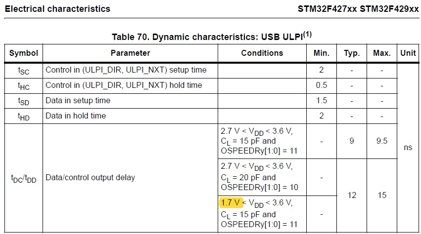

Hi, one more thing in this topic - I have found such information in datasheet (pictures below).
It looks that USB OTG HS (controller only; not FS transceivers) should work with VDD=1.8V. So it should be possible to use USB HS only (with external transceiver via ULPI) at 1.8V. Am I right?
