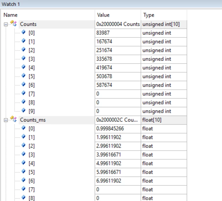

Hi, I am using a Nucleo F401RE running at 84 MHz (8 MHz XTAL PLL'd up to 84 MHz) and then using Timer 2 as a simple counter to count how long it takes to run the delays.
Timer 2 is set to run at 84 MHz with no prescaler and I am using LL_mDelay for the delays. I have a function which converts the counts to milliseconds. You can see in the timer2 function I am simply reading the count, delaying and resetting the count. However every one of my LL_mDelays are a millisecond over what they should be.
Eg LL_mDelay(1) takes 2 milliseconds, LL_mDelay(0) takes 1 millisecond.
Any ideas why this is? I have attached the watch window output and the project as a zip.

Posted on August 15, 2017 at 15:36
Please use a 'Syntax highlighter' section for pasting code.
Looking at LL_mDelay function's code it seems there is a bug there:
#define LL_MAX_DELAY 0xFFFFFFFFU�?�?
void LL_mDelay(uint32_t Delay)
 __IO uint32_t tmp = SysTick->CTRL; /* Clear the COUNTFLAG first */
 /* Add this code to indicate that local variable is not used */
 ((void)tmp);
 // !!! BUG?: This condition will pretty much always be true, so we will get one more millisecond than we desire
 /* Add a period to guaranty minimum wait */
 if(Delay < LL_MAX_DELAY)
 Delay++;
 while (Delay)
 if((SysTick->CTRL & SysTick_CTRL_COUNTFLAG_Msk) != 0U)
 Delay--;
See my comment starting with '// !!! BUG'.

Posted on August 15, 2017 at 16:25
You are totally correct, I commented the lines and the delays are all correct. I hope ST can fix this, seems a large oversight seems as it is the only official delay function provided.

Posted on August 15, 2017 at 17:17
Giving it another thought, maybe not so. I think this function is not intended to be very precise. If you need precise delays use a hardware timer with interrupts.
The thing is, when entering into this function the time may already be, for example, on 900-th microsecond of a millisecond, so the next millisecond will tick just after 0.1 milliseconds.
That condition that you commented out moves the possible skew to from 'taking up to millisecond less time' to 'taking up to milliseconds more time'. Maybe the developers decided that it's less desirable the delay take a little less time than a little more time.
