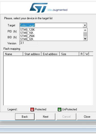

we are working on Nucleo STM32H743ZI , we are trying program through Flash loader by using UART to this controller but in target board only showing STM8 boards, how to get resolve this issue.

Use STM32 Cube Programmer in UART mode​
