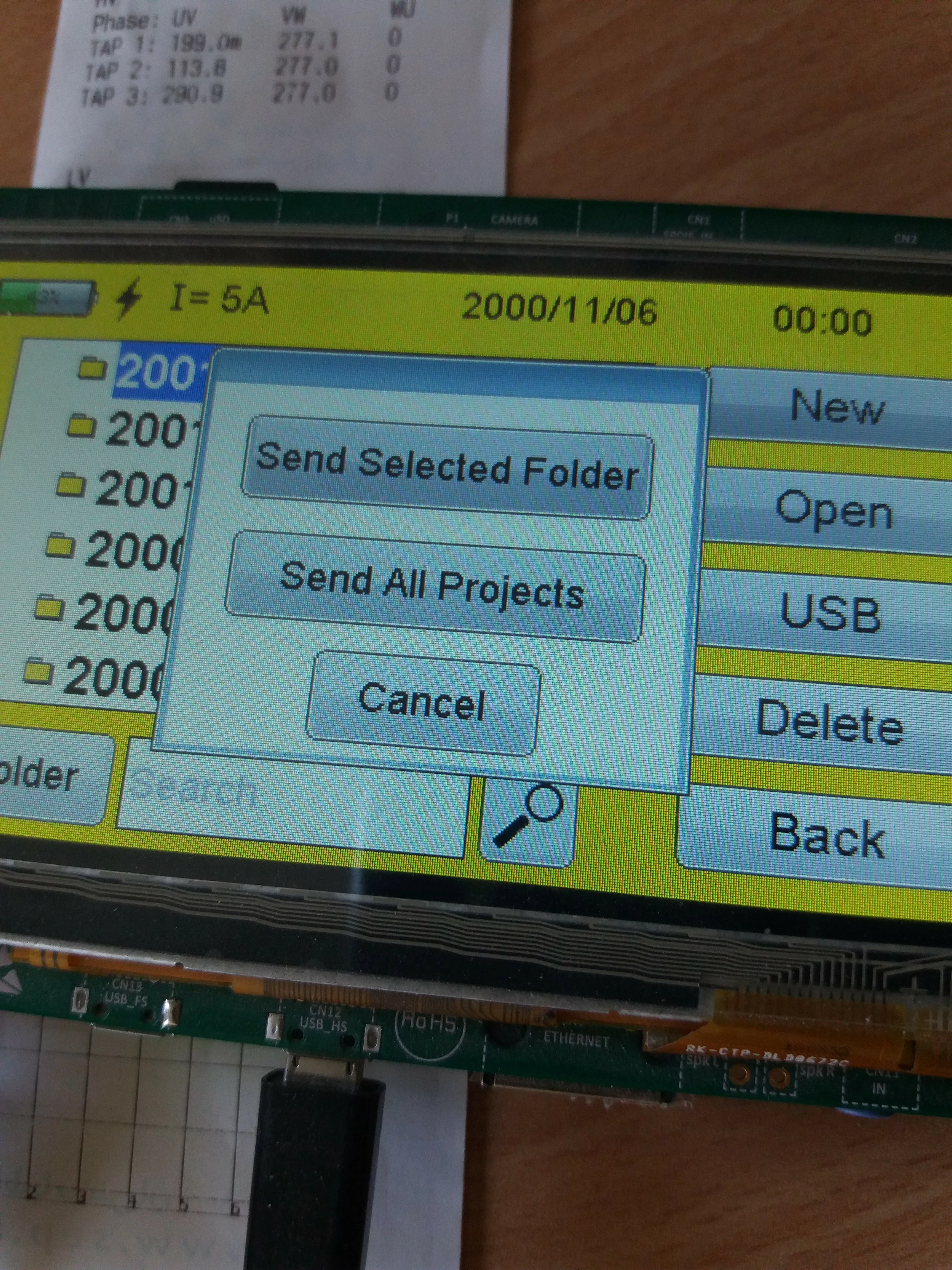

we had performed a project with discovery f746 board that within it there just was a GUI task to run emwin functions.
Another functions(such as reading and writing in sd card by fatfs , usb, spi and stuff) were placed in the routines of Buttons.
After several times the process of USB (writing in USB flash memory) was ran ,
the running process stuck in RTOS's functions.
After that we decided to add another thread for USB In such a way that, after pressing related button ,a message is sent to this thread.
At the first it works fine but after several times running this thread, mkdir function (for creating a folder in USB flash memory) returns FR_NOT_ENOUGH_CORE value and the program stops running.
For resolving this problem we increased stack and heap size and memory that is assigned to the thread but it didn't affect.
Could anyone help us to resolve this problem?
We'll appreciate your suggestions.

In our project we have an sd card that some files and folders are saved on it.Now we've added USB msc mode in our project and we want when user press the "USB" button those files and folders saved on sd card would be transferred on USB flash memory.
As I mentioned in first post after several times running the routine (send files and folders on USB flash memory), mkdir and fopen functions return FR_NOT_ENOUGH_CORE.
Now we want to delete usbthread when the data are sent completely and when user press "USB" button again the usbthread be created again and in the end of thread, usbthread deleted.Unfortunately we couldn't do this until now.
