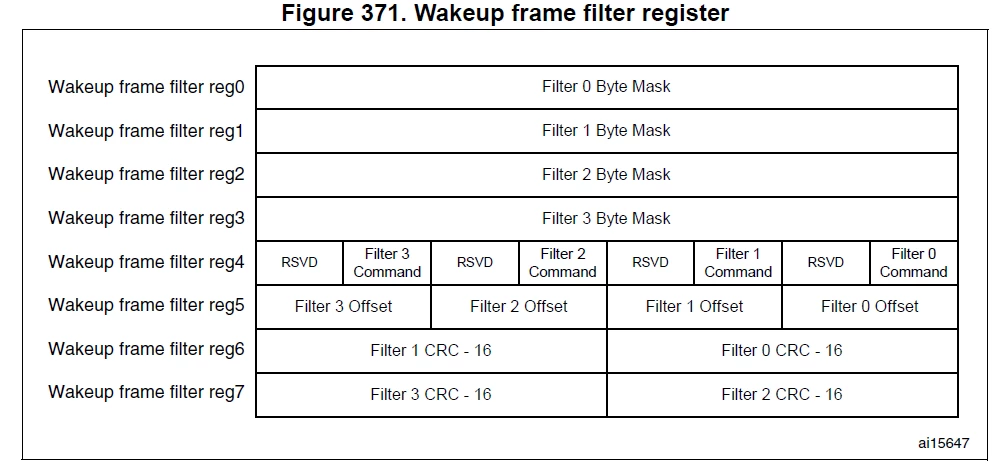

How do I use the Ethernet PMT remote wakeup filter register for STM32F407?
  • September 15, 2020
  • 0 replies
  • 584 views
What is the polynomial in CRC16?Crc16-ccitt, CRC16-IBM or something else?I tried everything I could, but it didn't work?Can someone help me?
Here's how I set up this register:
uint32_t wakeup_filter[8] = {0x00ffffff, 0x00000000, 0x00000000, 0x00000000,
                0x00000001, 0x00000013, 0x0000f40e, 0x00000000};
thank you!
