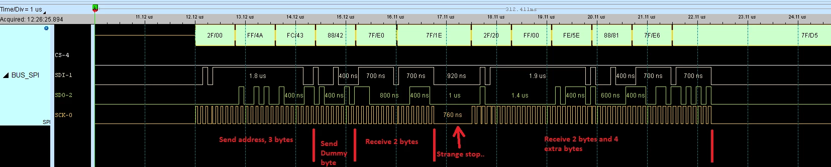

However, I have another problem. If I receive 1 byte or 2 bytes (Nbdata =1 or Nbdata = 2), it works perfectly. But if I try to receive 4 bytes (Nbdata = 4), then it receive 8 bytes (checked by a logic analyzer) so it is not correct. Do you know what could be the reason?

 Here you can see the _Init:

 And here the output at logic analyzer:
