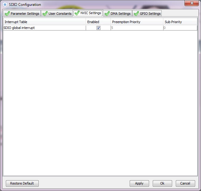

I have a question in regard, FreeRTOS, Systick and Timer2 ?
How can I use Timer2 as Systick in FreeRTOS ?
And what is the relation between SDIO preemption priority global interrupt with FreeRTOS ?

Are you using GCC?  If so then all you need to do is
1) define a function with the following prototype to setup the timer you want to generate the tick interrupt
void
vPortSetupTimerInterrupt
void
2) Install the existing xPortSysTickHandler() function as the timer's interrupt service routine,
3) Set the priority of the timer's interrupt to the lowest possible.
In answer to your second question - and the priority bits for an interrupt that uses the FreeRTOS interrupt safe API should be set to be pre-emption priority bits, not sub-priority bits.  See the following link for more information:
http://www.freertos.org/RTOS-Cortex-M3-M4.html

If you are using Keil then you need the additional step of ♯ defining configOVERRIDE_DEFAULT_TICK_CONFIGURATION to 1 in FreeRTOSConfig.h.
