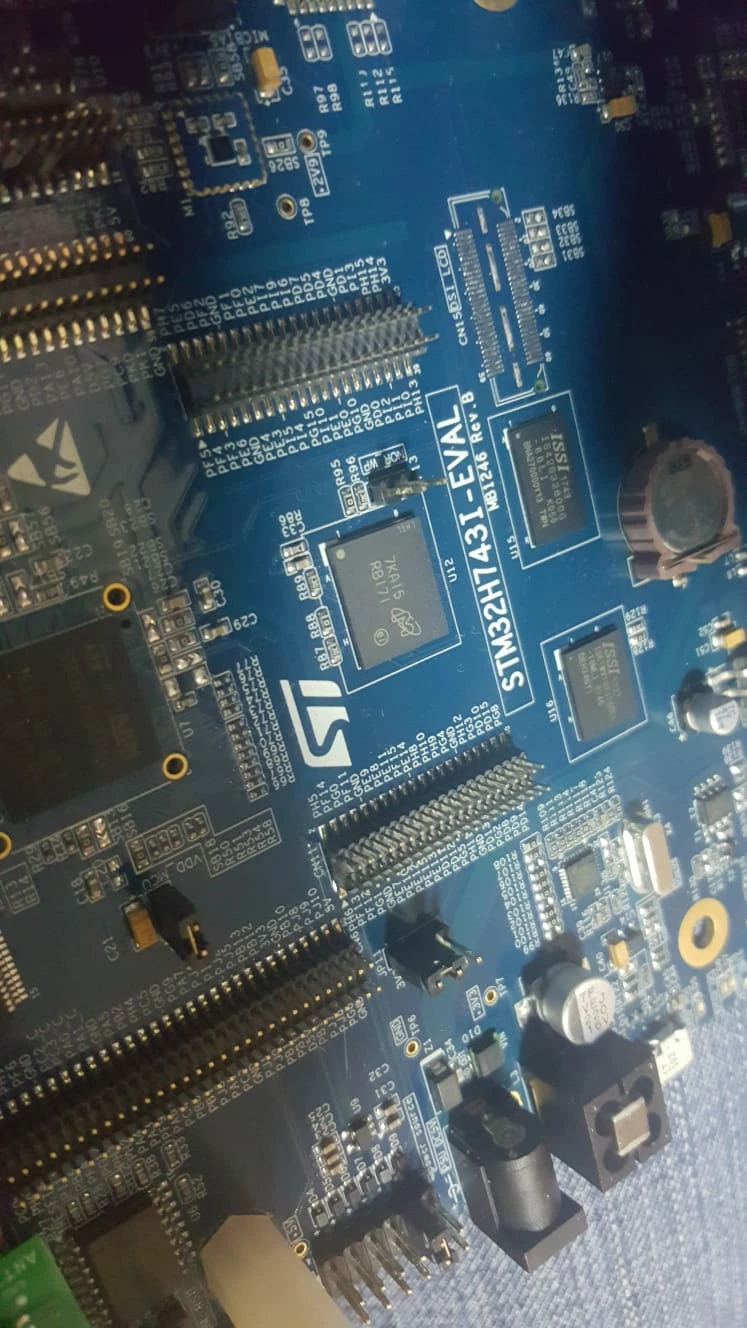

I run the FMC nor example for stm32h743 eval, with the eval board, and I get very poor timing:
I used the original configuration , and only changed DataSetupTime   from 8 to 10 (with the original configuration, the test fails with my eval board ! ).
Yet, the write speed of NOR flash is extremely slow:
Writing 64KB took 3 minutes and 10 seconds --> speed is 360 B/sec !
Does it make sense that nor write is so slow ? Is it the HW write speed or ineffective write routine (or both) ?

The oddness here is that the external loaders (Keil, ST-LINK) can access the NOR fine, with what looks like the same timing settings, but STM32Cube_FW_H7_V1.3.0\Drivers\BSP\STM32H743I_EVAL\stm32h743i_eval_nor.c and calling BSP_NOR_Init() doesn't seem to provide data properly at 0x60000000 memory window.
What revision of EVAL board are you using, and what stepping of H7 silicon?

I don't know, have we even establish what device is mounted on your board. The examples say it is an PC28F128M29EWLA, which is nominally a Micron or Intel device depending on who owned the fab at any given time. http://www.marketwatch.com/story/micron-to-buy-out-intels-share-of-flash-joint-venture-for-15-billion-2018-10-18
ST's loader uses the alternate name of a notionally equivalent part, or second source part#
M29W128GL_STM32H743I-EVAL
Examining the .stldr file, the PLL and NOR timings seem to be the same as those described in the NOR BSP file for the board. And do read, write, verify the content properly. For a megabyte, or so, this takes a few tens of seconds, not minutes to occur.
The issues at the application level seem real, but it is not my project, and I can't spend hours of time troubleshooting it. ST did not furnish this board to me, and they are not paying for my time here.

January 13, 2019
Hello Clive,
Can you please see image.
I don't understand.
In U12 , it shows 7KA15 (not like yours).
Yet, According to this page
https://www.micron.com/products/nor-flash/parallel-nor-flash/part-catalog/mt28ew128aba1lpc-0sit
It seems that I have mt28ew128aba1lpc (7KA15 is the FBPA name for the chip).
Another interesting thing I noticed, if is that systemclock_config has much influence on the time it takes to do the flash nor programming.
I still not sure which exact clock is responsible for this.
Thank you!
ran
