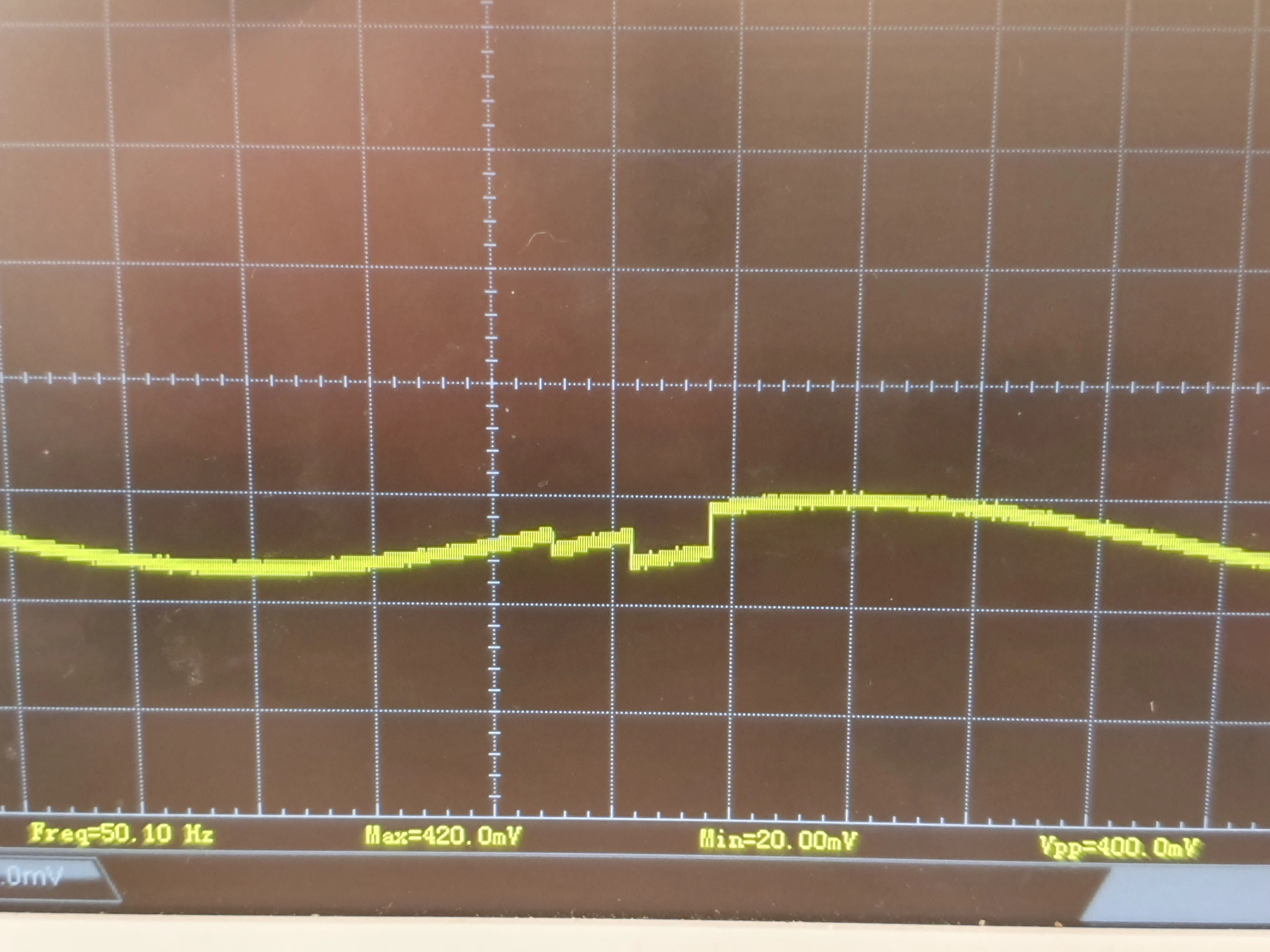

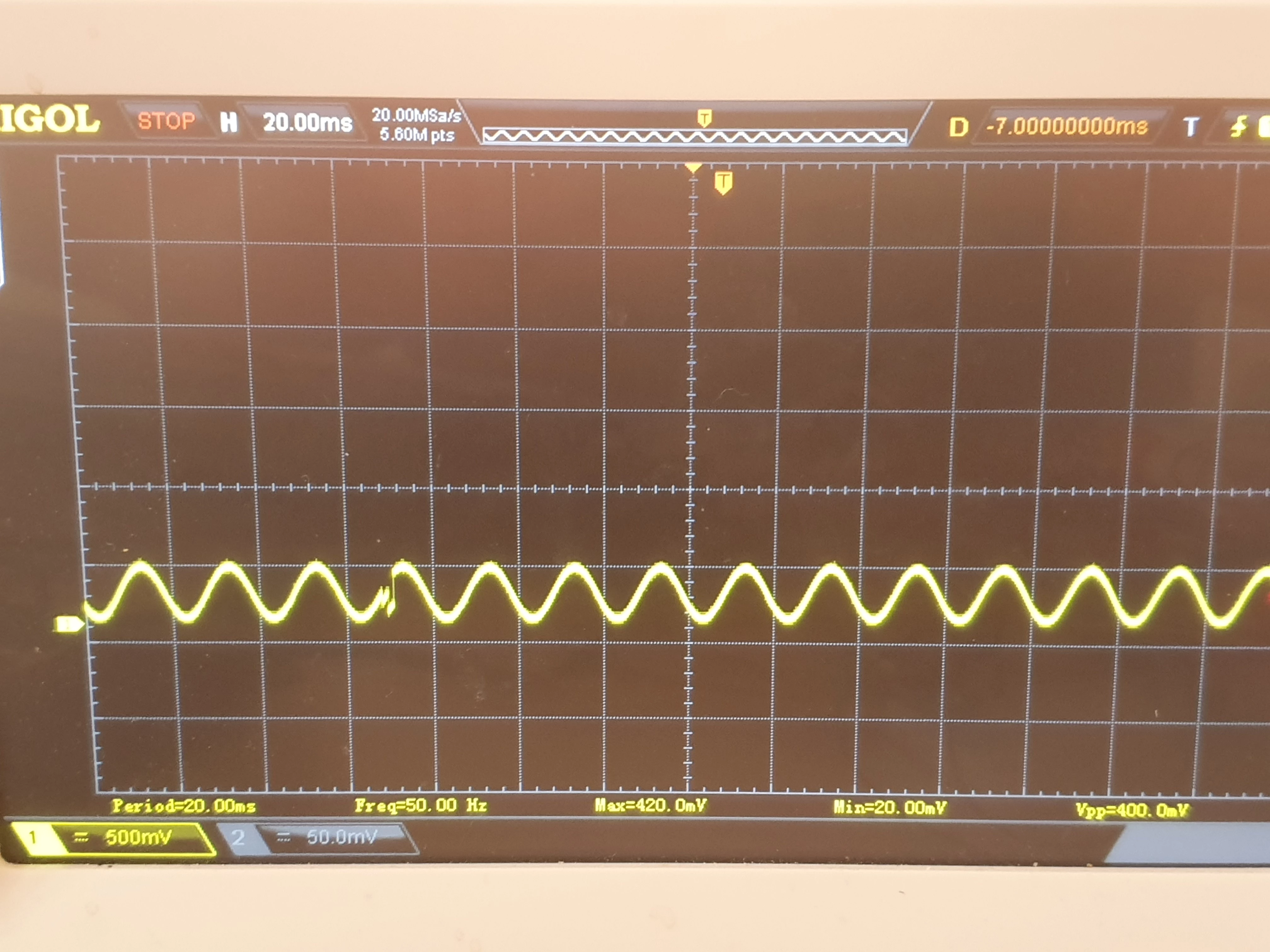

Hi, I am using Nucleo F303re with STM32 HAL Libraries built by STMCubeMX in order to implement an USB Audio player with bulk transfers. I changed the USB-CDC code a little bit to implement my application. I receive the data in the CDC-Receive-FS function and copy the data in there to a buffer used by DAC in DMA Circular mode. But everytime DMA starts to read the buffer from the beginning again i get an error equivelant to 16 samples of data. I am posting the error and the code here. My data is being sent with libusb in 480bytes chunks in regular timing. My array supplied to the DAC on the board is 19200 bytes and even if i change the size of the array it always happens at the beginning of the buffer. If i make it 9600 bytes error happens every 9600 bytes. If i make it 19200 or even 38400 it happens at every 19200 or 38400 bytes.

There is no such thing as regular timing in workstation software. And there are no identical and absolutely stable hardware clocks either. Oscilloscope actually proves it - it can be seen clearly that the device plays previous buffer data - different fraction of the same sine wave.

Thank you again. I will use i2s if i dont like 8bit or 12 bit resolution data from internal DAC. But maybe the same problem would occur again as I2S also uses DMA as DAC as in this applicaiton. But the problem is i was wrong when i was sayin real time data transfer. Actually im sending 10ms worth of audio data which is 480bytes at 48khz sampling rate at intervals. Like the First data arrives and the second one arrives at 6th ms. And the others start to arrive at 16th 26th.. and so on. So im sending the data in chunks and giving at least 4ms for the transfer and copying to DAC buffer be completed. So the data is always arriving before DAC starts to process that data. So it is not actually real time. And the problem appears always at the beginning of the buffer. If i define a small buffer or a large it always appears at when DMA turns back to the beginning of that buffer and im always supplying that buffer with different data. So maybe the problem can be about something else.
