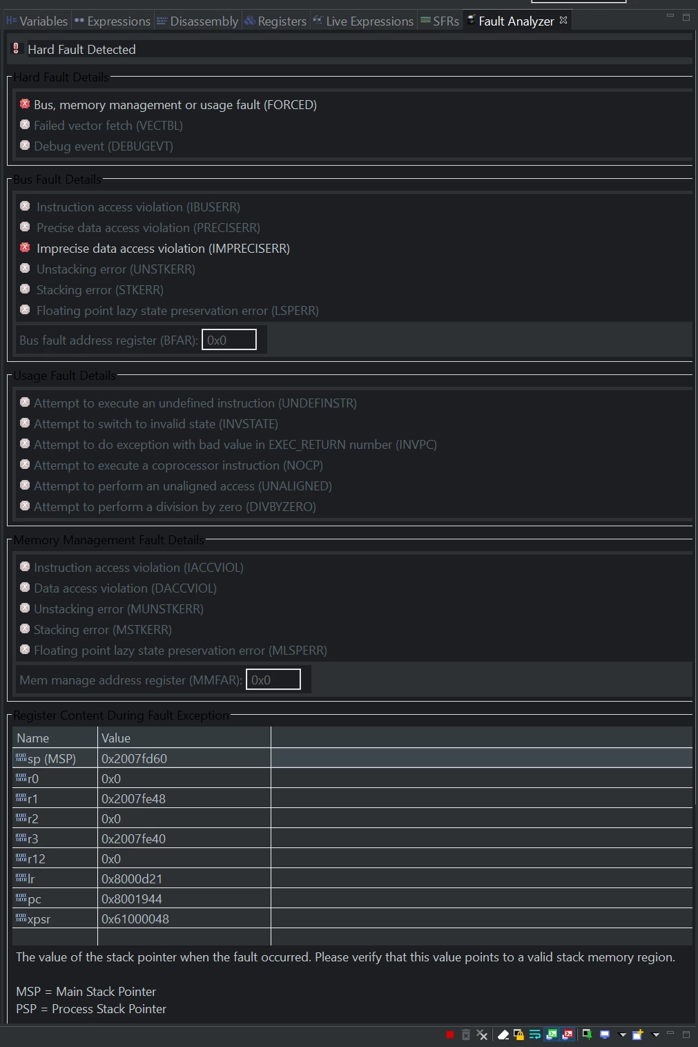

I've a NUCLEO-F767ZI. I'm having problem getting the arm_fir_q15() to work, it gives me a hard fault. I'm defining the variables like this:

The problem I'm having is that after the call to arm_fir_q15() the system goes to the hard fault loop, giving me this:
If I use arm_fir_f32() with the appropriate float variables, coefficients, etc., it does function normally. What might be causing this hard fault?
