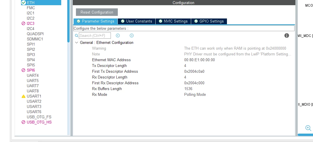

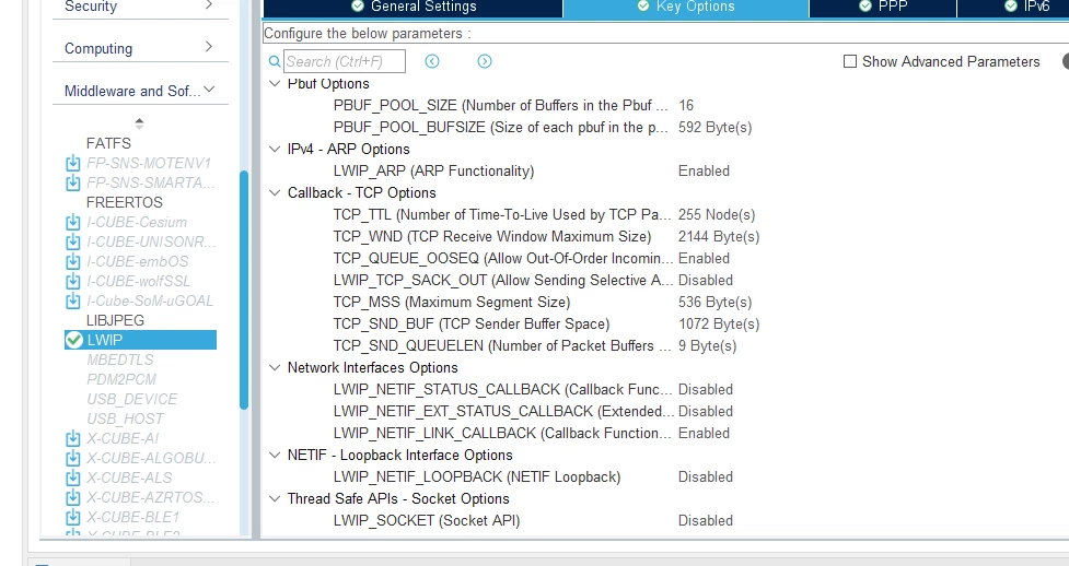

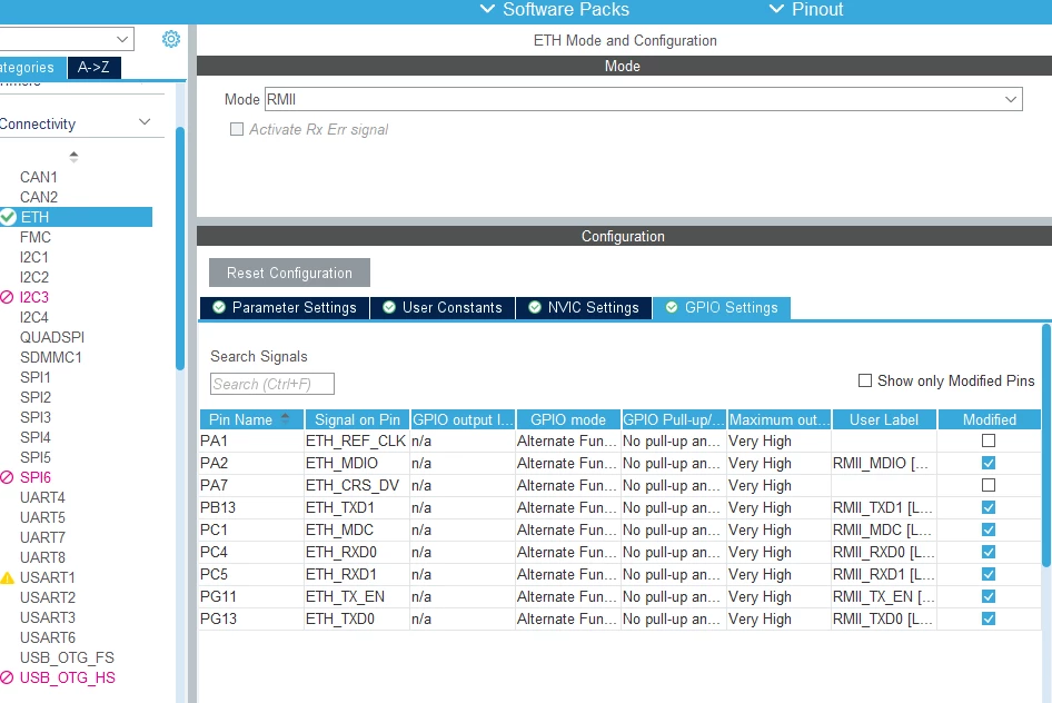

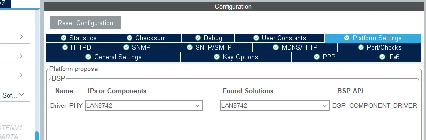

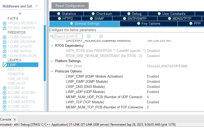

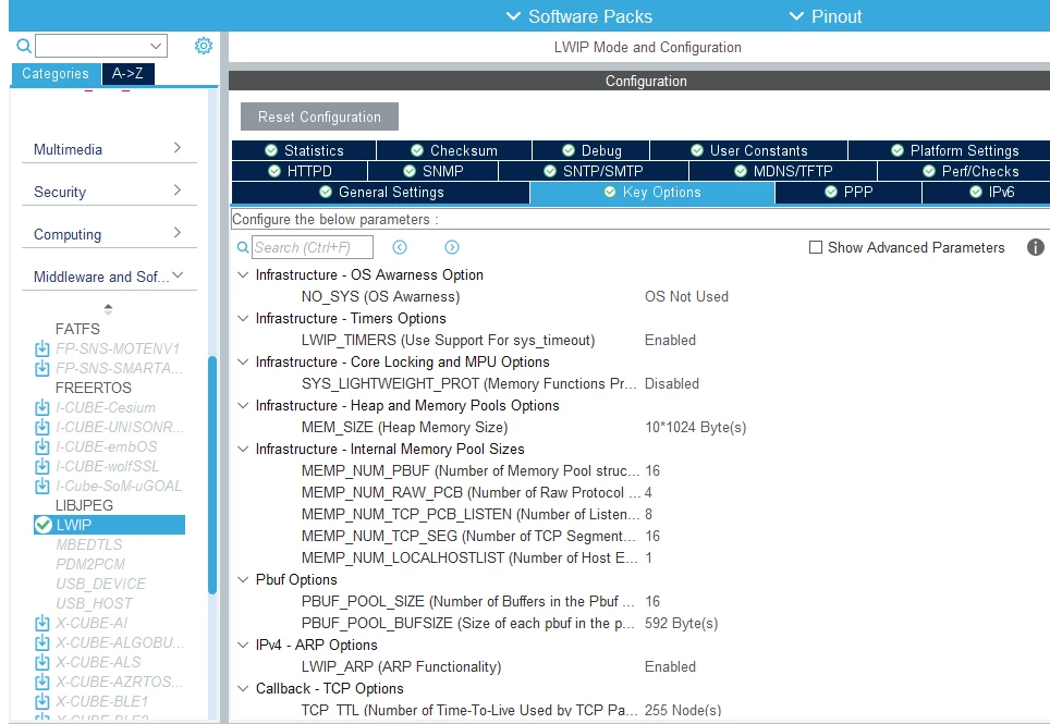

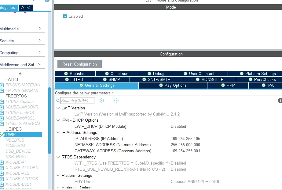

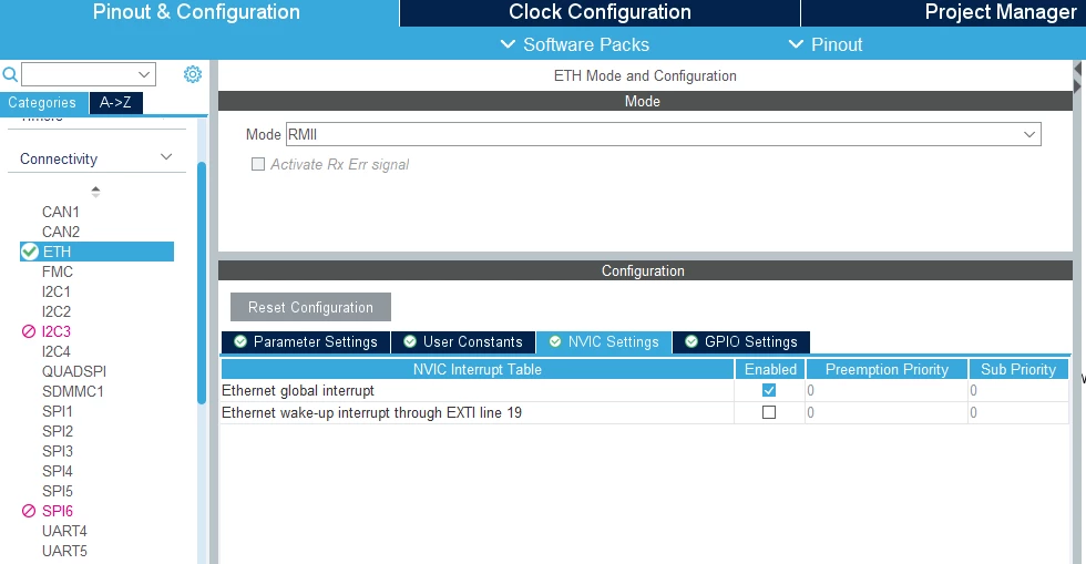

I am using Nucleo F746 eval board. I configured ethernet and lwip. But I can't get ping. "Reply from 169.254.255.144: Destination host unreachable." I get feedback like: My ETH and Lwip configurations are below. Can you help with this issue?

Hello @HS_it
I suggest you to start from this exemple's configuration.
Best regards.

September 28, 2023
Open the project in CubeIDE and then in the main.c compare the configuration in this project to your configurations.

Hello @HS_it ,
The STM32F746xx devices are based on the high-performance ARM®Cortex®-M7, for that it is recommended to configure cortex-M7:
  • Enable ICache and DCache.
  • Enable memory protection unit (MPU) in “Background Region Privileged access only + MPU Disabled ...” mode. Configure regions according to the picture below:
Could you please check the MPU configuration?
