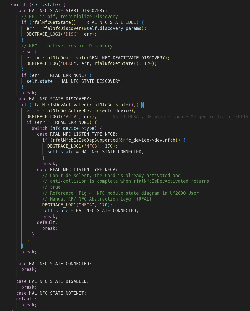

sdesai32Author
September 24, 2026
Hi Brian,
Thanks for your reply, I did not know that when rfalNfcIsDevActivated returns True, it means that the card is activated. I was able to confirm that after code inspection as well as the reference manual you linked. I have since removed the HAL_NFC_STATE_POLLING and the Tag moves to HAL_NFC_STATE_CONNECTED once rfalNfcIsDevActivated is true and RFAL_NFC_LISTEN_TYPE_NFCB or RFAL_NFC_LISTEN_TYPE_NFCA active device type is detected. The new consolidated states are pasted in the comment below, please let me know if you notice any redundancies there.
I studied some examples for Type 4A/4B support in the XCUBENFC6 software package and noticed that rfalIsoDepPollBHandleActivation is only called for Type 4B listen type device and not Type 4A.
Can you explain why the same check is not done for Type 4A?

Brian TIDAL
September 25, 2026
I guess the question is why rfalNfcbIsIsoDepSupported() is called for an NFC-B listen device, and why a similar function is not called for an NFC-A listen device.
The NFC Forum defines several types of NFC-A listen device, such as Type 1 Tag (now obsolete), Type 2 Tag, and Type 4A Tag. Type 1 Tag and Type 2 Tag do not support the ISO-DEP higher-layer protocol.
When the application detects an NFC-A listen device, the demo_polling.c demo distinguishes the device types and uses ISO-DEP only for tags that support this higher-layer protocol:
case RFAL_NFC_LISTEN_TYPE_NFCA:
platformLedOn(PLATFORM_LED_A_PORT, PLATFORM_LED_A_PIN);
switch( nfcDevice->dev.nfca.type )
case RFAL_NFCA_T1T:
platformLog("ISO14443A/Topaz (NFC-A T1T) TAG found. UID: %s\r\n", hex2Str( nfcDevice->nfcid, nfcDevice->nfcidLen ) );
break;
case RFAL_NFCA_T4T:
platformLog("NFCA Passive ISO-DEP device found. UID: %s\r\n", hex2Str( nfcDevice->nfcid, nfcDevice->nfcidLen ) );
demoAPDU();
break;
case RFAL_NFCA_T4T_NFCDEP:
case RFAL_NFCA_NFCDEP:
For NFC-B listen devices, the application must also check whether ISO-DEP is supported. The code performs this check through rfalNfcbIsIsoDepSupported().
