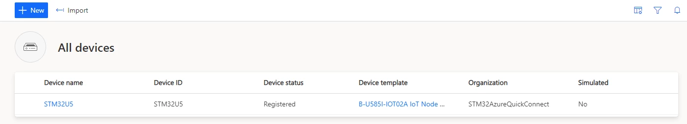

4. Add A Device to the Central Application
In the menu on the left select ‘Devices’
Select ‘New’ to add a new device
Enter a unique ‘Device name’ and ‘Device ID’
Choose ‘B-U585I-IOT02A IoT Node 2 discovery kit.’ as the Device Template.
Make sure ‘Simulate this device’ is not selected
And select ‘Create’
Your new device should now populate in the devices tab

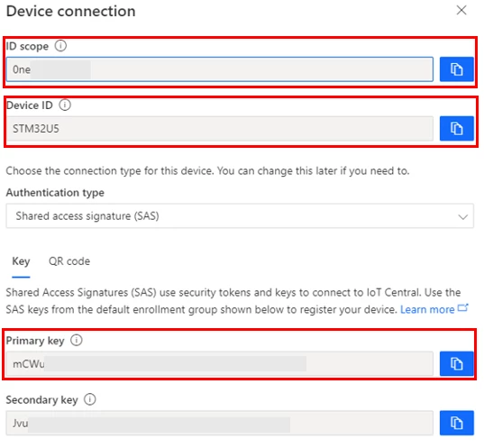

5. Collect Connection Credentials
Click on the ‘Device Name’ of the device you want to connect to
Click ‘Connect’
Here you can view all the required device Connection Credentials

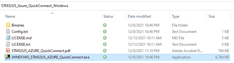

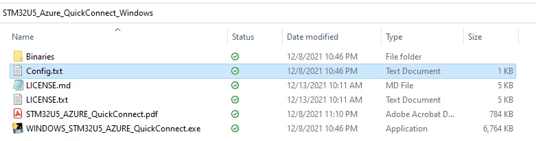

In File Explorer Navigate to STM32U5_Azure_QuickConnect  and open Config.txt
Enter the Wi-Fi SSID and Password for your 2.4Ghz network
Copy and Paste the ID Scope, Device ID, and Primary Key into this file and save.

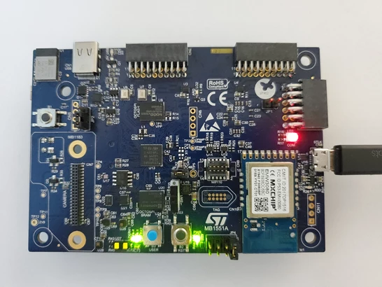

6. Run Quick Connect Executable
Connect your Discovery Kit using the Micro-USB cable as pictured below

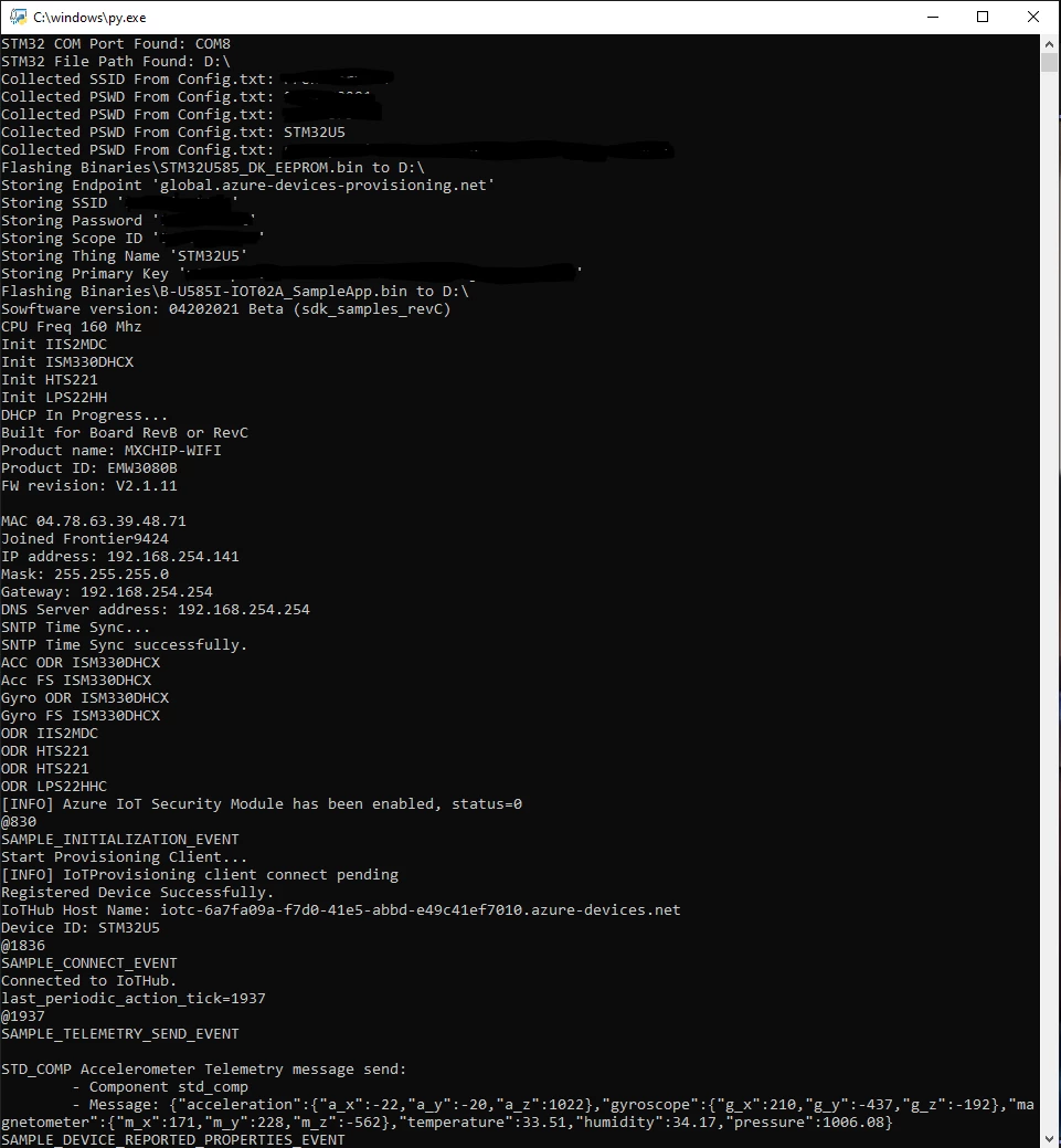

Ensure that you downloaded the correct STM32U5_Azure_QuickConnect package for you operating system above and run the STM32U5_AZURE_QuickConnect.exe
Script logs can be seen in the window:

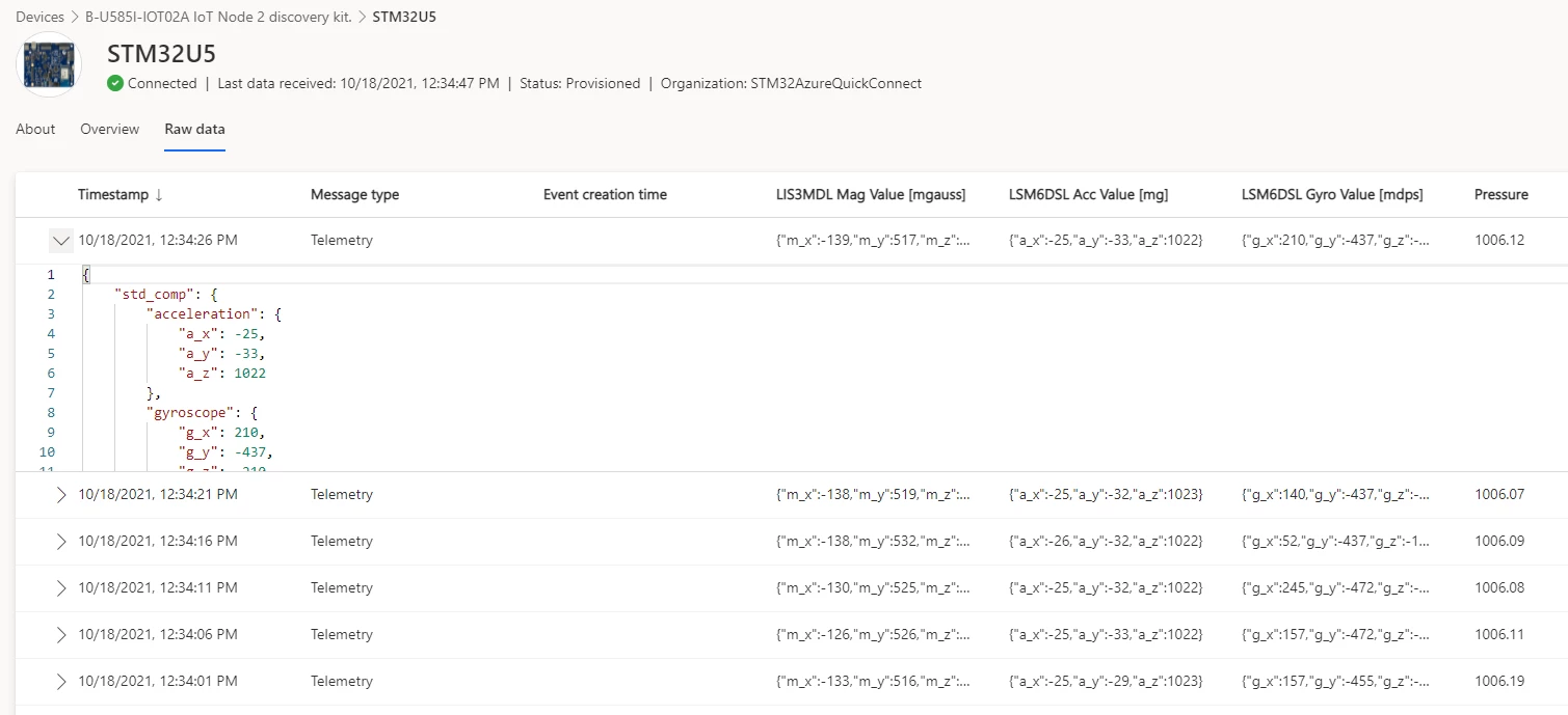

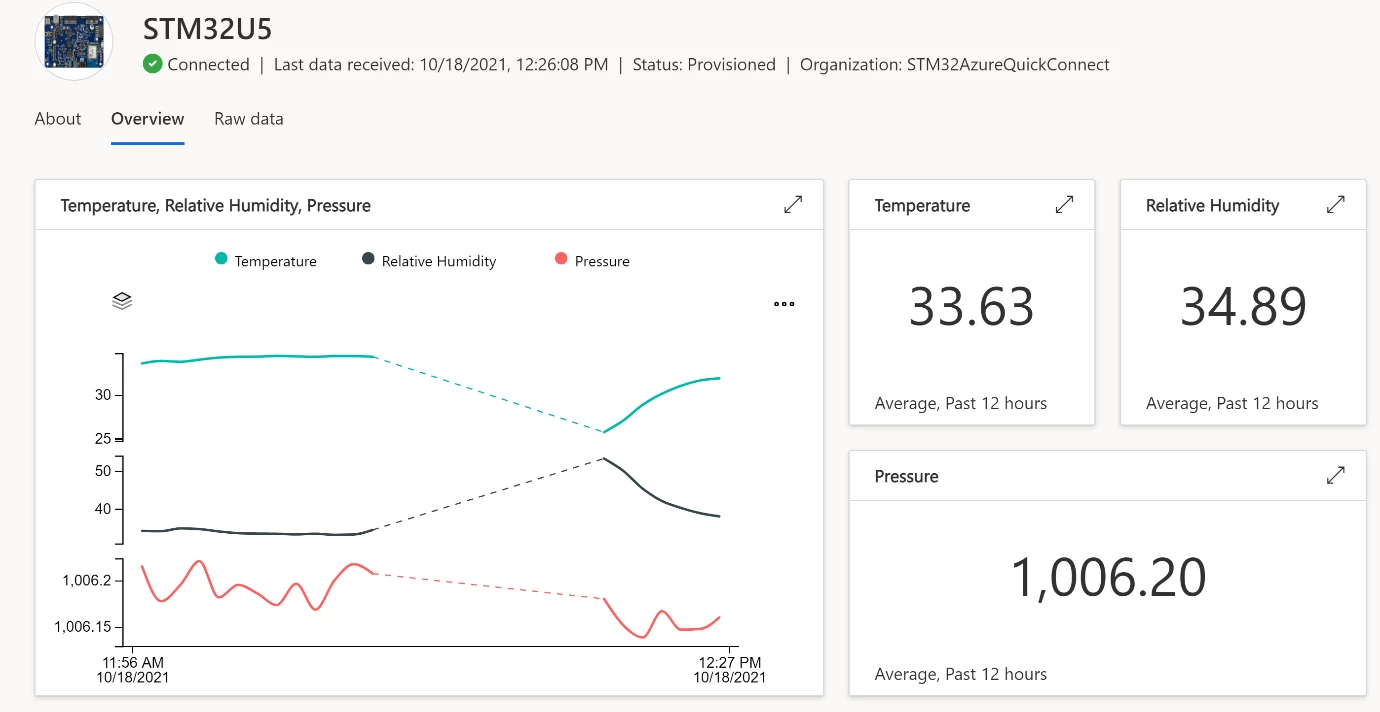

8. Monitor Device Activity
Navigate back to your device in your central application and you can see a summary of the incoming data
Under ‘Raw data’ specific MQTT messages can be viewed
